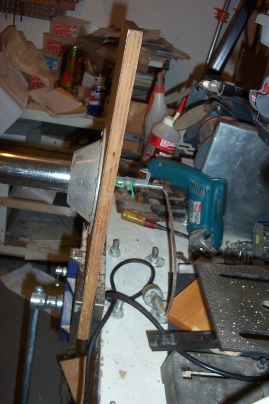

Sam I use a heat gun for my touch up pipe (2" piece of SS with a cap on one end) and my cutaway bender. I havn't tried it with the router reostat yet, but I bet I could control the heat that way.
Here's a pic of the cutaway bender.

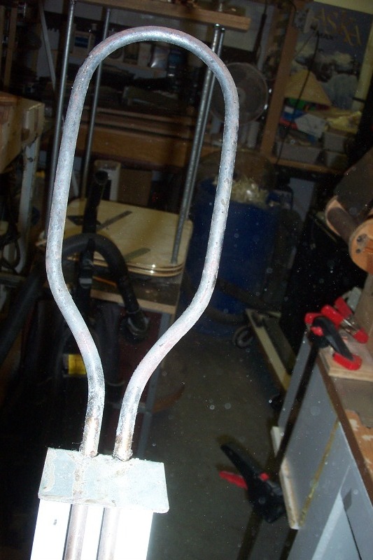

Cheers!! Thanks for the pic, Rod, and Tony, that's something else to think about.
You mean one of of these??
Sam Price39053.6784722222

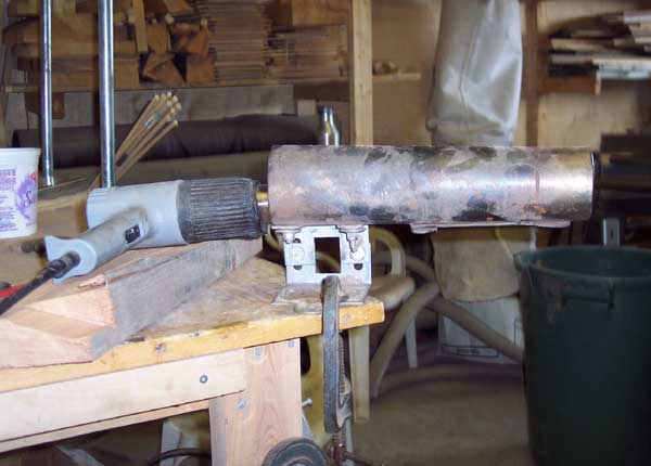

Here is my cheapo pipe. I use a heat gun, used to use a torch but prefer the gun now
PostPosted: Sun Dec 03, 2006 4:19 am
Hey Richard, do you just throw the switch and let the gun heat up the pipe to what ever temp it gets to? Or do you have a way of controlling the temp? Just wondering if the reostat or router speed control would work for this.

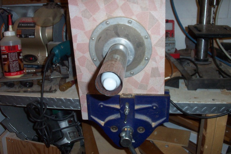

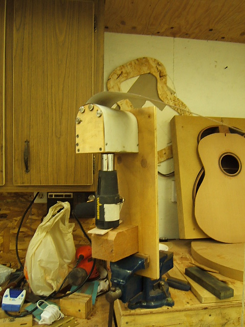

Oki Sam, finally got a pic or 2 for ya, sorry for the delay!
my cheapo pipo thingie
But this is what i'll be using from now on!
PostPosted: Sun Dec 03, 2006 1:19 pm
Posts: 749
Rod, My Heat gun (bought it at Canadian Tire for about $30 years ago) has a high low switch and I find between the 2 settings I can always get the perfect temp. I just heat it up on low till water dances on it for Maple and similar woods or on high until water evaporates right off for Rosewood. As I said I used to use a torch but find this much safer and the temp is just right.
